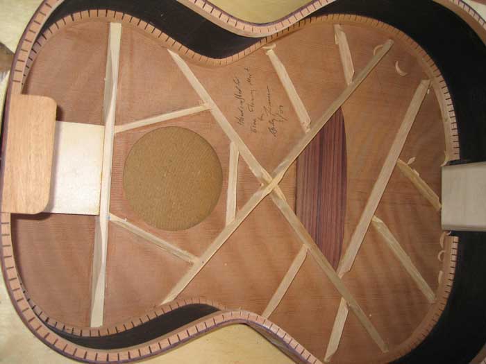

PostPosted: Sun Jun 24, 2007 2:28 am
Here is an example of it flat but tied into the extension block

I dome everything, then fletten the part where the fingerboard is glued on. There is so little sanding requierd that I don't see the point in leaving the transverse brace flat.
Azimmer, the extension block or neck block on your guitar seems to be glued on asymetrically, was it on purpose or a mistake? If on purpose, what was the purpose?
